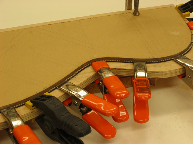

Hi everyone; I got my grooves cut and am ready to install the herringbone and binding. I have bent hardwood bindings before, no problem, but the herringbone is to be bent edgewise. Is there something special I need to know? Do I use my bender or should it be done by hand? If I use the bender, how do I keep the purfling up right. I mean, won't it tend to fall over? Any advise is welcome. Thanks

Soak it for 5 minutes in warm water, then take one side of your bending form and attach it temporarily to a piece of plywood...bend the herringbone around the form using spring clamps to hold it flat and in contact with the form...leave overnight...works great...below is a link to the OLF thread where I originally asked this question, and a photo of the way I went....
bending herringbone
Hope these help!

Good technique. if you have bender you can bend it in the machine also. I tape it to binding when I bend so it won't twist. I like simple and the above pic works. Before the bending machine days I used to heat it in HOT water then tape it to the guitar over night.

I'm going to use this technique for my next herringbone. The firs stuf I bent was tough to keep from twisting - this method looks like it will solve that problem.
-Mark

Sure thing Mark! I bought 2 extra strips when I did it and didn't even have to use it! Looking forward to seeing your guitar pix posted on the OLF!
